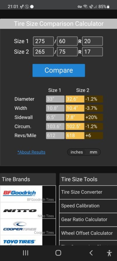

I plan to replace my summer 20" alloy rims with a set of 17" alloys whenever it's time to replace the tires.
The 17" rims with a larger profile tire provide better comfort from my experience.
You might want to consult with an online tire comparison calculator before choosing your new tires to match the circumference within 4% unless you use AlfaOBD to program the tire size.
My summer and winter tires are a different size which I correct with AlfaOBD.
When I entered 265/70R17, the difference was more than 4%.

Using the tire calculator I linked above, you can tweak the tire sizes and it will display both the % difference in circumference and the speedo error at various speeds.
And yes, this % of error will impact the odometer and speedometer.
There are several apps that will allow you to correct this error. AlfaOBD is my preferred because of other available tweaks.
