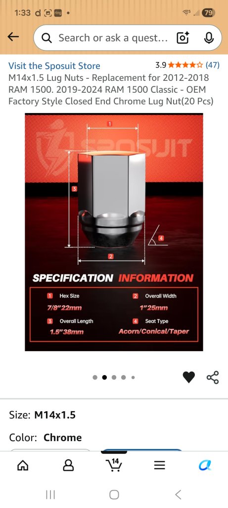

I purchased the below lug nuts for my 2017 Ram 1500 with 20x8 factory wheels.
Sposuit M14x1.5 Lug Nuts - Replacement for 2012-2018 Ram 1500, 2019-2024 Ram 1500 Classic - Closed End Chrome Lug Nut(20 Pcs)
My mechanic says that these will not fit. He says that the angle is correct, but the top of the shoulder is too small and the lug nut could eventually work its way into the center of the lug nut hole.
He says I need a nut made to factory specs.
What are some of you using for your lug nuts?

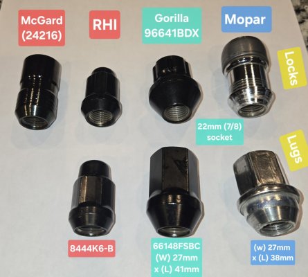

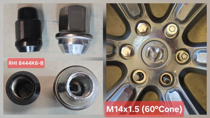

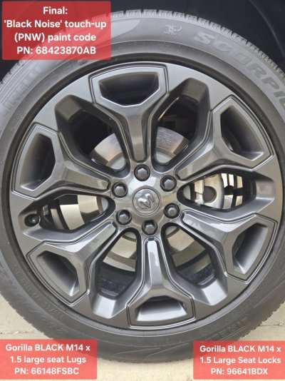

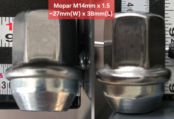

I'm not an expert on this since Acorn/taper 'sounds' similar to me but the terminology that seemed to match up best in my opinion was ... 60° "large (or extra large) cone seat" and in my opinion you need to be able to see actual dimensions of what you're buying to compare to the OEM lugs.
>> The Gorilla Lugs seem to hit the mark across the board <<
Note:
>> the RHI and McGard brands did not have the correct "Large" cone seat and would have likely pulled into and possibly though the aluminum rim seat at some point.
I'll copy/repost my pictures from the other thread here for reference: (Post 45, Post 50, Post 52 & 53)
References:
Gorilla CHROME M14 x 1.5 large seat Lugs
PN: 66148FS (Chrome Single lug link)
Gorilla BLACK M14 x 1.5 large seat Lugs
PN: 66148FSBC (Black Single lug link)
Gorilla BLACK M14 x 1.5 Large Seat Locks
PN: 96641BDX (4 pack set)

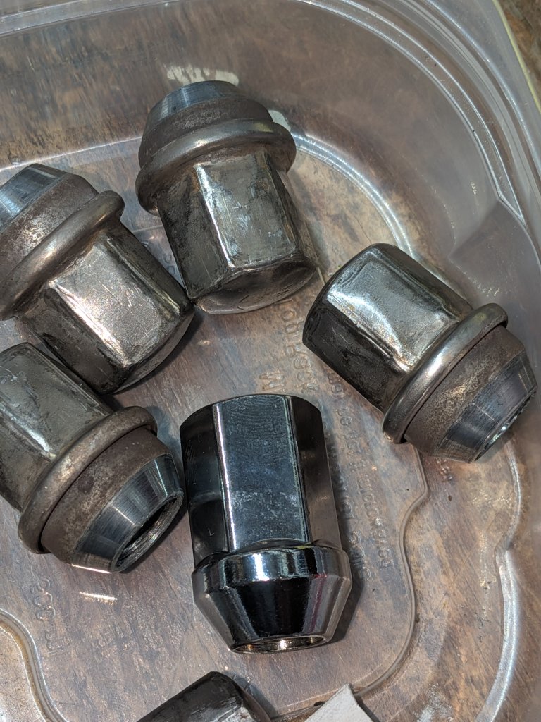

Mpgrimm2, thank you for your help with this. I took off two of my lug nuts to compare. One that is probably factory, because of the chrome cap, and one that is solid metal. Their dimensions are identical. The new ones I purchased are way too small.
