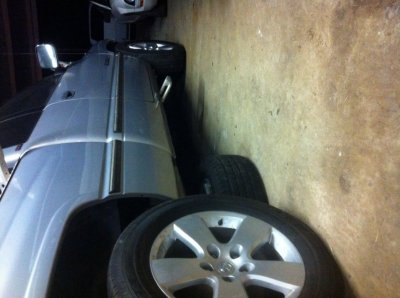

I have a '96 2wd and i got a set of flower pedal 20" wheels that wont go on the front, the center hole in the wheel is not large enough to go over the last quarter inch or so of the spindle. i think i need a spacer.
Hey 96 I have the 2012 ram rims and they had the same issue like you're talking about. The back fit like a glove but the front won't sit on the whole way. I took a router and an extra hub assembly. Bore out the center hole a little and check your progress with that extra hub. Very time consuming but worked like a charm for me. You will need to hit the back a few times but shouldn't be near as much as front (outside of rim). This is all for the 2012 rims. Not sure if the pedal rims are similar. Here's a pic

I'll try and get some better pics tomorrow. Lemme know if you have any questions
