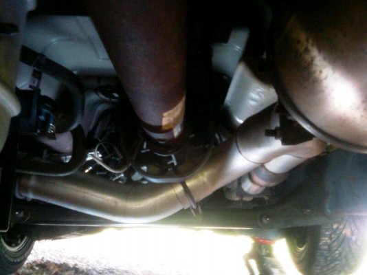

For the op, this was right after install of headers
https://www.youtube.com/watch?v=Ph3bso1vrW4&feature=youtube_gdata_player
Also get you some stage 8 locking header bolts (ps they are a ***** to get on) and get some mopar gaskets. Moesperfomance sells em for a good price.
And to hemibjorn, if your cali bound (assuming you mean moving there) dont take the risk cali is so strict on their **** its not even funny, my 01 failed inspection cause it had a k&n aftermarket intake set up on it...

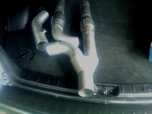

03's can use a single cat if it and the muffler are moved rear ward. You can also use dual cats placing them in the front section of the ORY placing them pretty much over the trans cross member. This requires the ORY pipes to be cut the length of the cats. Shield any wires close to the pipes.

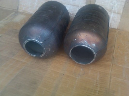

I don't have codes and I used two Magnaflow spun cats. I also have a matched pair of 03 cats I was going to use but they were bigger than I wanted to use. Space is a little restricted above the cross member.
Here is a pair I have cut to take 3" pipes without restriction, IMO nothing out flows these. And they are for Sale as a pair only.
