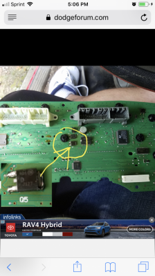

I’ve been dealing with this Odometer issue for awhile now. The picture above of our gauge cluster, you can see the ccurcuit board under neath right? If you take the silver screws out of the black plastic bezel which holds the gauge cluster together, you will find the circuit board. On the Curcuit board you will see what I’m going to call “micro chips” if you will, start checking ALL the solder connections and you will hopefully find your problem. See photo. Another solution is Searching instrument cluster repair, I’ve found a few companies that you would have to send your gauge cluster to and they repair any problem with it. About $100-$150. This is much cheaper than the dealership and buying the whole dash just to get a new gauge cluster since dodge discontinued the manufacture of just the gauge cluster. I hope this helps, believe Me I know how frustrating this issue is. Take care.
