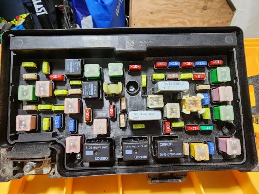

So the instrument cluster on my 11 ram 3500 randomly goes crazy as I’m driving. Truck runs fine but warning lights are on wipers come on speedometer and rpm gauges all die then it goes away. Very intermittent. Any ideas?
is the issue still continuing? Mine continue intermittently for a few months and later became more frequent. I was able to fix it by removing the TIPM and cleaning it using a can of electrical/electronics contact cleaner and using a small paint brush (just make sure to put add tape on any metal parts and make the brush hair shorter by cutting or taping till only about half an inch is left before you brush the board) but make sure to check all the fuses before doing this step. I removed mine before doing the fuse check and found one of the fuses a 20 amp was bad, may have been just a bad fuse but unlikely.
