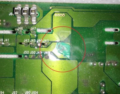

Q
quick6black
Mar 30, 2015
16
I think i may have isolated the issue. I decided to take apart the IPM and found some corrosion. I attached some pics of the board.

RonJon '06
Jan 2, 2014
3,372
1,184
Southern Minnesota
2014, 1985
6.7, 360
It looks like you found it, nice work. If only it could have been a $2.00 fuse.
Q
quick6black
Mar 30, 2015
16
I wish it was that simple...and cheap. Looking over how the box was constructed its no wonder it failed. Sealed from the top but open ports on the bottom. Going to see if my father in law can re-solder the connections, he has a degree in electronics. If not see how bad dodge is going to hit me
Redtruck-VA
Jun 29, 2010
5,864
985
Virginia
2003 & 1989 D250 RWD
Hemi-5.7, 5.9 12v & 24v diesel
I have read folks have installed jumpers. Hopefully you can back track to a joint and maybe use a different socket. Or hardwire the sucker and bypass the corrosion completely.
