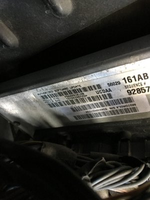

There is a TSB for the P2706 code for PCM replacement (PCM can shut the vehicle down), if you can get me the PCM serial number I can let you know if it is covered by the TSB.

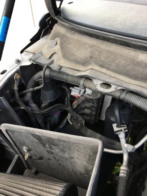

There were a few numbers on the box, attached is a pic. Took an extra pic where the box was located (on firewall, with plugs showing colored dots).
Thanks for your help.
View attachment 126190 View attachment 126191
The TSB does not apply to your vehicle, but the solenoid packs are known problems. Make sure you check the harness for shorts though.
