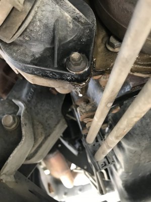

Would anybody know what would be leaking from my 2005 Dodge Ram 1500 V6?

Looks clear or semi translucent. Guess would either be AC condenser drain water or brake fluid. I have also seen the windshield wiper motor/arm area under the cowl that has a clogged drain from leaves and debris also cause it to overflow and have rain water drain down the back of the engine.

It looks the picture is from the front of the engine looking toward the back of the truck? If so water pump would be my guess.
