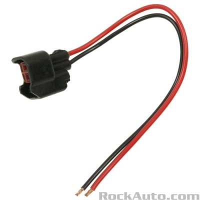

I had a similar issue after re-assembling my top-end job. The OEM injector connectors are are weird design with the retaining clip on the very end. Turns out one of them snapped and the injector was losing connection. I bought one of these and spliced it in, no further issues:
https://www.rockauto.com/en/moreinfo.php?pk=663922&cc=1430806

Thanks you I double checked all the clips yesterday and sure enough cylinder 8 clip was loose fixed the clip and few miles down the road CEL turned off
