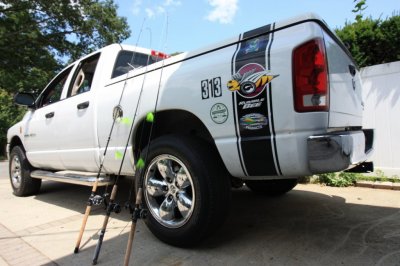

Looking to replace my 5.7 with some performance / HP torque upgrades . My 05 has EGR but no MDS. Heard the 6.4 is the same block as 5.7 but not looking to rock the boat, don't want to replace harness or confuse computer.IMG_4328.JPG
