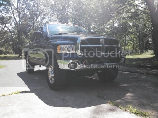

Have any pictures of the truck? Not many RCLB power wagons out there

this is the best pic i have for now. truck came from syracuse, it was more or less a special order, dealer had a hard time to find one.

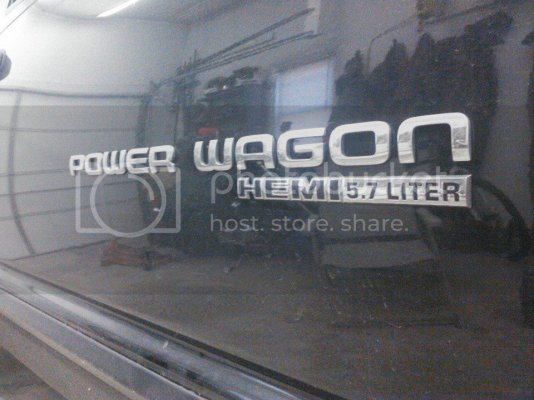

and i just had to include mine in there.. lol
