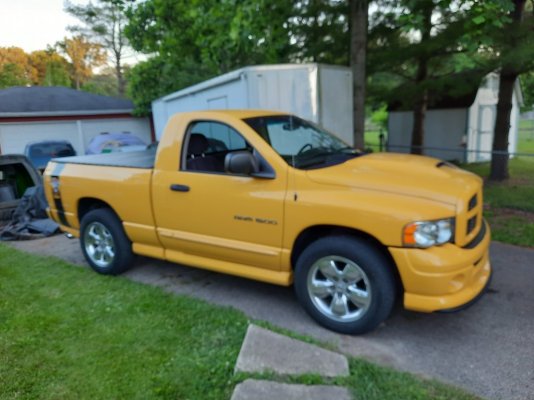

I am new to this forum & have been looking around for some answers, I have raced 426 Hemi for 30 years, all of this electronic stuff is new to me
I have a 2005 dodge ram rumble Reg cab 2WD SB with the 5.7 hemi & the killer tick, eating the cam
will a 6.1 hemi go in with out a whole lot of trouble, ??
