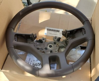

On my 2009 1500, the steering wheel is a mess. I bought a replacement one and it turned out to be brown instead of gray. Started looking for another and decided I'd try to get a leather wrapped one instead of the rubber wheel but the listings are confusing and most of them don't show 2009 being the same as 2010-2011. But they look like the same design.
Mine has the EVIC controls. Are all the wheels with the cutouts for the EVIC controls interchangeable? I've searched all the threads in the 4th gen forum and couldn't get a clear answer.

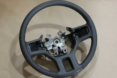

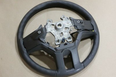

The controls should be fit any wheel from 09 - 12. In 13+ the EVIC controls were changed and the controls do not fit the same cutout as the the 09-12 years.
What you have pictured will work.
I managed to get me hands on a factory fresh leather sport wheel a few years back and made the swap. Everything was plug and play.

Thanks, that's what I was thinking. As long as it has the early EVIC switch openings it should fit. A leather wheel would be best since the rubber wheel doesn't feel that great in the hand.
