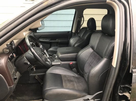

2009 Chrysler 300 Srt-8 seats in 03 RCSB

Looks amazing man.

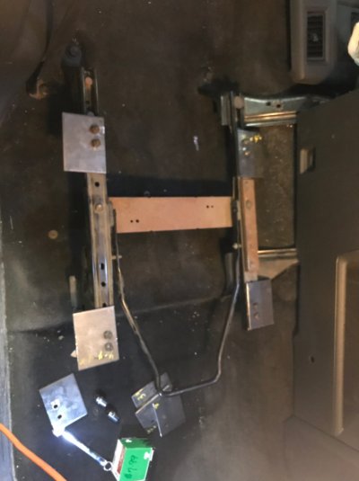

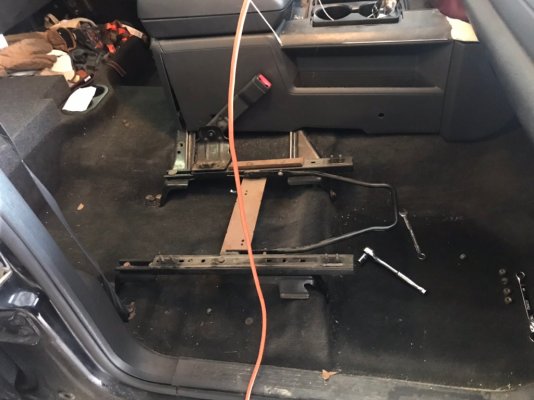

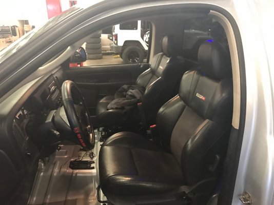

I just got mine in today. They came out pretty nice, working on the wiring now. Jerry gave me some tips on how he did his and I did similar. I left the truck floor brackets in and made up a simple flat plate at each corner and bolted them to the frame. Then drilled holes that lined up with the seat and bolted them to it 76d4ec304df6eda0d50c5a662e34f15d.jpg

Very nice
