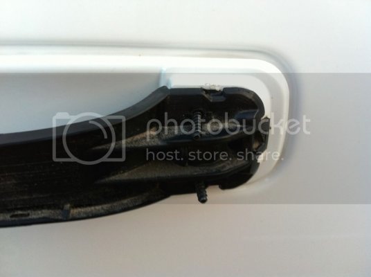

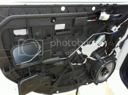

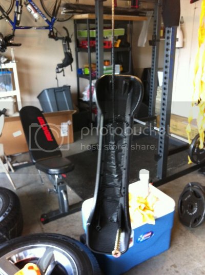

Well I got bored yesterday so I went ahead and took my inner panels off and then worked one handle off. Sprayed about a 1/4 can of plasti-dip on it and then remounted a few hours later. I'll attach some pics. Some :homoswitch: at Dodge thought it would be fun to put 2 tiny allen head screws in the front end of the handle. The only way I could see to get to them was to wedge something in the handle to hold it pried apart and then slide a very small allen wrench in. Turning about a tenth of a turn each time. In the pic of the handle hanging I stuck a screw in one of the small holes to help control the handle while I sprayed. It won't be used at all today, so I'm hoping that many coats, with this much time to set up will work better. If not, then its off again to be painted.
Taking this black panel off was WAYYY too much work, so I just slid a socket into that black cut-out to loosen the handle.

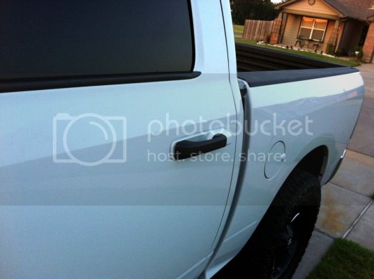

Finished all 4, thought I'd show a couple more quick pics in case anyone ever wants to try this at home..
This one shows the actual screws..
And the finished product. Used 2.5 cans of dip to cover all 4 handles. I wasn't going to risk them not getting a good enough coat and peeling again. Let them set out in the sun at 90 degrees all day yesterday to make sure they were set up and then remounted today.
