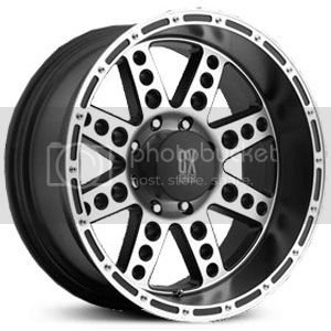

Oh they will be lol. The wheels I liked were discontinued and only offered in -24 offset but they are 20 x 10.
Any wobble issues on your level?

You will need atleast a 3.75" lift (such as an RCX 2.5" + 1.25" body) to clear those
