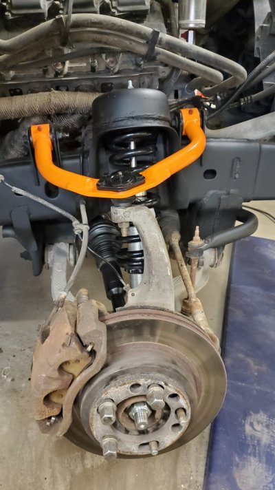

Hi there, i have been working on my truck for just about a year now (on and off, busy life) and now that ive been driving it... i kinda hate it ‍... the suspension is all over the place and im not really sure why.
I re did the front end with jba upper control arms and i got a set of fox 2.0 in the front that i got used and had rebuilt. The problems are the truck sat a half inch lower on the driver side when the shocks had the same pre load settings (gas tank was almost empty) and when you go over a dip in the road it felt like the back end was wiggling side to side. So I leveled out the front and it seemed like the truck was going over dips and bumps just fine....went over a big one and then it felt like the truck was bouncing around from 1 corner to the next. I've hit these same bumps or dips in over
Ther vehicles and they act normal. Idk If I forgot how the truck drove and it's always don't this or if this is new fron suspension changes. Do I have the front to tight? (It is set so it's slightly higher in the front, I also have fox 2.0 ifp's in the rear) I feel as of the truck isn't balanced and Is almost not really stable or safe on the highway. Any advice is appreciated!20220807_223954.jpg20211204_143253.jpg

Is the upper control arm marked right or R, one the passenger side? Thar pic looks odd, almost like the UCA is on the wrong side?

I was kinda thinking the same but I have been reassured that it's the right way, and they weren't marked as I also got those used

Not sure what else it would be in that case. Other parts with issues?
Did your alignment guy have any issues? Can the previous owner send you the instructions?

No but the alignment seems off. I might get in contact with the company that rebuilt them. They were kind of a pain to deal with that's why I came here and where I live we don't have any offroad shops that will play around with this stuff.

Those arms do look backwards. Post up your alignment output paper.

I dont even have the papers haha. The front alignment is I think still slightly out. I watched the video right from jba offroad and it shows then also the same way. But it wasn't a tech from there own company tho.

#1 - you shouldn't be able to move anything in the rear at all when they're mounted up and torqued to spec. Make sure the control arms are oriented the correct direction as there is a frame and axle specific side. Not sure if bushing width is different between the two but I'll bet the farm thats your issue. Vulcanized clevite bushings should have no play anywhere, ever.
