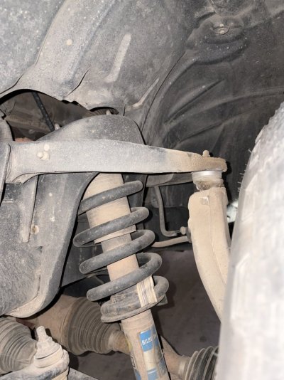

My front end is noisy and my truck hops sideways when going over bumps. Previous owner said the front suspension was replaced 20k miles ago but my sway link and cv axles have lots of play in them. It has Bilstein 5100’s on the front. Stock rear.
So my question is, will I need modified cv’s going back with new?
Should I go ahead and replace the rear end as well?

what are the 5100's set at for lift? Also post a pic of your CV angles and UCA's. You may need angle correcting UCA's. Modified CVs are not necessary. How many miles on the truck? What exactly was replaced in the front suspension?

Im not entirely sure what all was replaced or what they were set at but i plan on replacing most of it due to the rough ride. Sway links are bad too. A bit of a mess down thereIMG_9660.jpeg
