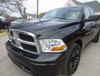

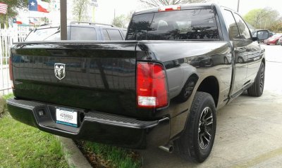

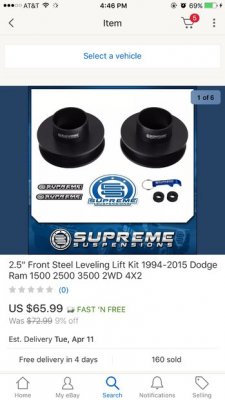

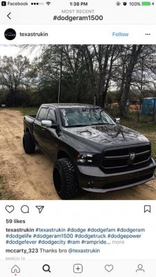

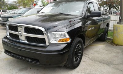

Can someone help me out?
Dont know what size lift to get!!
Its either a 2.5 Supreme Suspension or a
3in front lift
My back is stock 2"
Also what size tires would be great with this?!
I attached my truck and a truck of what i kind of want my truck to look like!
Also i added photos of the lifts :)
THANK YALL!!!

Good lookin' truck! Though this is the third gen section, and you have a 4th gen, I'd go with a 2" leveling kit to begin with. Then I'd probably go with 285/70R17 tires (assuming you have 17" rims, which that's what it looks like from the pics), which will be close to 32.5 or 33" tall. You may or may not need small spacers on the front to make sure the sidewall of the tires don't contact the Upper A arm or the spindle.
