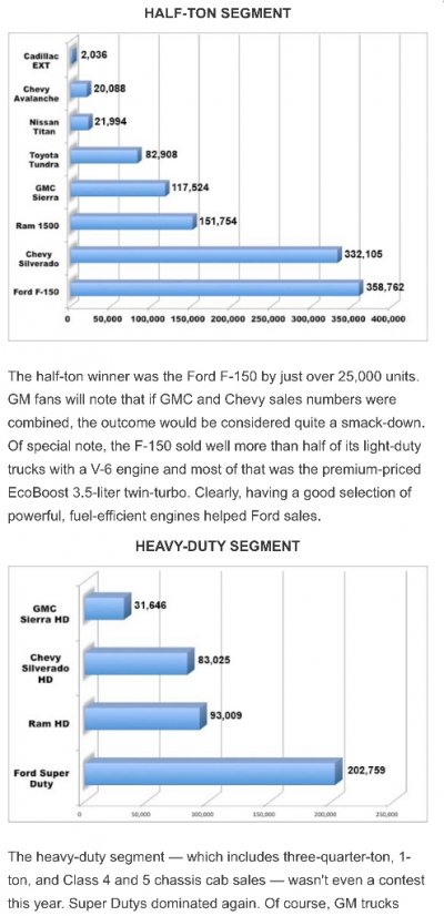

Let’s be fair they don’t see Tundra because they don’t sell many. Let’s look at 2011 sales since that seems to be a bad year for lifters.
If Ram sold double the trucks each year you will likely see more Rams. The same should be true of Ford vs any brand.
