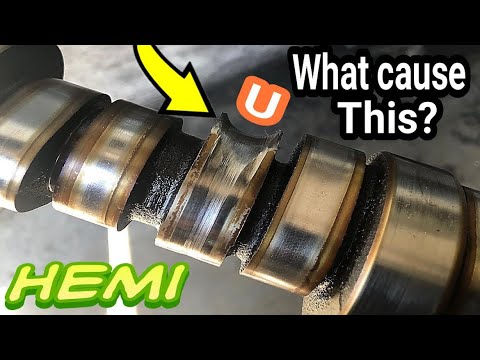

In order for a mis fire on 5 to be cam related, the cam lob would need to be worn to the nub. At a minimum it could be pitted to hell and back, so total B's the cam caused mis fire unless the cam lob looked like it did in vid below.

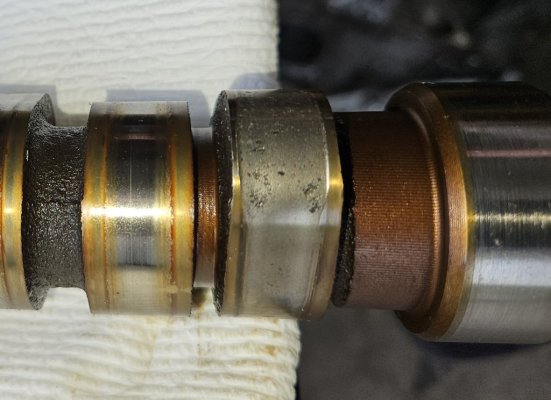

What does "not as much wear as he's seen/far less than what he would normally see" mean?
If it's worn/wearing, it needs replacing, but why is it worn? There is a cause.
Here is my #5 intake lobe. Not yet to the point of a misfire, roller needles on lifter were shot.
Here are both lobes for #8 cylinder, both lifters still good, but lobes are worn just through the surface, and won't be long for the world, IMO.
With your friends continuing misfire, I wonder if he might have an injector issue as @Burla stated. Sounds like the only thing not replaced.
I wish you and your friend the best getting it sorted out.
Fair point! I have been trying to drink from a half full glass when discussing things with him - “at least you’re on the way to a bullet proofed hemi!”
