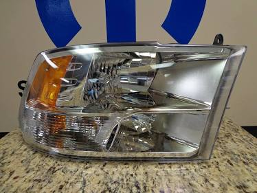

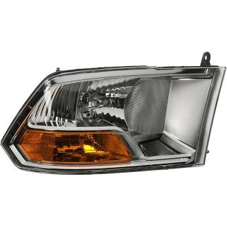

What type do you have now? Duals or Quads?
^^^ Duals
^^^ Quads
