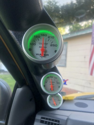

:biggun: :party36: :welcome: :party36: The 5.7L HEMI is very susceptible to serious engine problems, where oil pressure and coolant temperature is concerned. Because of it I run an additional oil pressure and coolant temperature gauges in my 07' Quad Cab truck.
