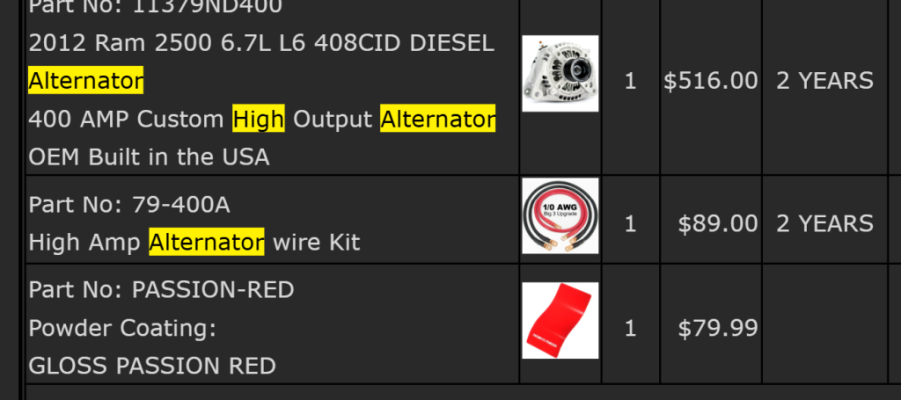

hello Ken. I just put 2 breand new batteries in with an upgraded alternator and the big 3 wiring upgrade. Its been using those for about 3 months prior to dying. I put 2 of these in it. It is Dualk Batteries

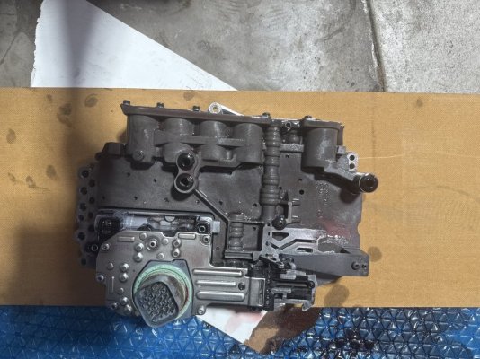

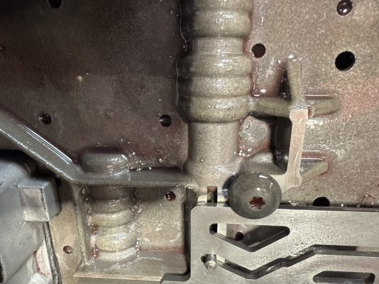

Ok so I charged the batteries to full. Based off research I bought a new transmission solenoid, both filters and new tabby fluid. So upon removing Tranny pan, this what I saw. I know shavings aren’t good but do I need to rebuild?
Fast69Mopar
May 10, 2019
2,438
2,667
Texas
2006
I think some more investigation is necessary here. Shavings are not good in any scenario but you may be able to make it survive a little longer before you need to overhaul.
If you could get the Autel scan tool connected and tell me what the CVI's are I could probably tell you where the problem is and if you had some time left before a major failure occurs.
