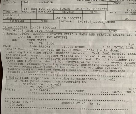

Thanks everyone for the Advice, I was towed off the highway in Urban, IL on Saturday 10/28 and Sat in a Quality Inn until the Ram Dealership had a chance to look at it on MondayThat was the explanation the Dealership gave me.. I’ll post a photo of the work order.FullSizeRender.jpegFullSizeRender.jpeg

It's not going to be cheap but you can definitely get it fixed cheaper than that. They basically took the easy way out and quoted you a complete (reman) drop in engine as opposed to a repair/short block + parts etc.

Love the Truck.. Just looking for Advice and what’s the best way to get it running.. It’s home safe in my Driveway. Willing to get it hauled to get the best work done.
There is good news in that invoice, you see the discrepancy is in the cost of parts not labor. You can solve the issue on cost, you just can't do it at the dealer. That price alone really tells you they don't want the job. Did you even ask if their parts is for a brand new engine or a reman? My guess it is even worse then the number, my guess that is for a reman, which could be wrong, but I'd at least find out and ask if there is an option for a reman if it isnt one. Find a local guy who warrants his work including labor for some miles, doesnt really matter how many miles even if it is only 6 mos on the labor, see if it is possible. If you can get a 6 mos warranty on labor and 36 or whatever on the engine, I'd go that route.
I wouldnt let anybody see that invoice, might influence the price they give you. Let them see the diagnose, not that part with costs on it.

that price is for reman'd, see here what you get. It really is a horrible price and a sad state of affairs these days. You can see the cost, same figure he wrote.

He did mention that it was a “Crate” motor.. I won’t show that to anyone .. I was just in sticker Shock at that time.
