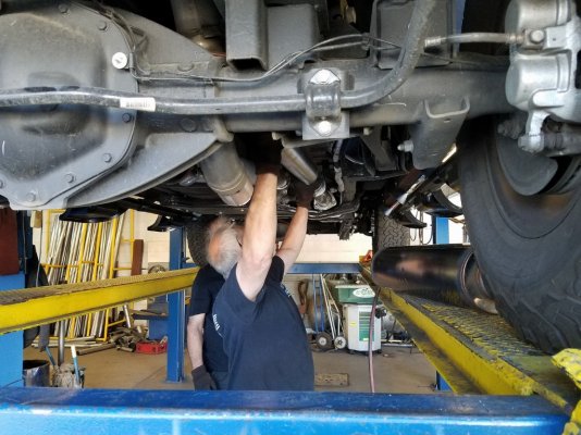

I fully deleted my 2017 last year after numerous codes and being stranded by the side of the road twice due to regen failures. None of the dealers I took it too could stop the codes and all they could do was reset it, sending me down the road. The truck had 5714 miles on it when it went into the shop.
I deleted the DPF system, the EGR cooler, the throttle valve and the associated cans that make up the exhaust/regeneration system. My intent was to:
1. Stop the codes and limp mode occurences.
2. Open up the intake and exhaust.
3. Keep sooty exhaust out of the CTD.
4. Add a tuning package to manage the mods.
5. Protect the transmission from case cracking.
6. Remove the shudder/stutter at WOT as it shifts from 3rd to 4th.
7. Eliminate error codes.

Exhaust Upgrade
FloPro 4“ cat & DPF cannister delete pipe
4” – 6” black exhaust tip with rolled edge
Corsa 8004002 4” muffler – placed just behind the down pipe

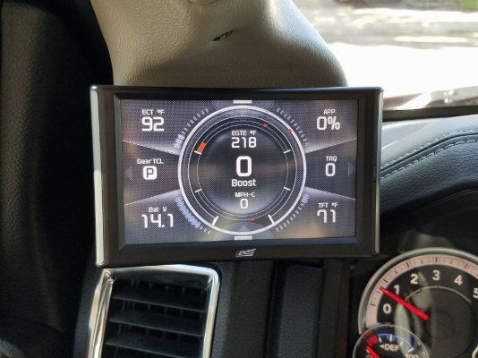

Edge CTS 2 monitor in A-pillar pod

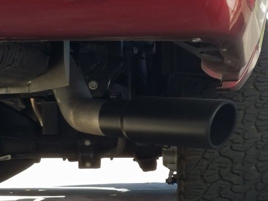

Exhaust work
Tip

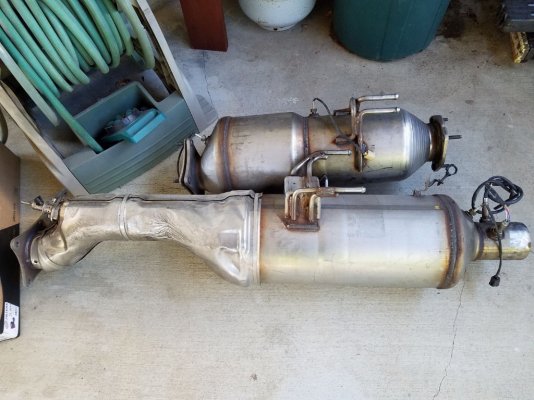

Exhaust cannisters

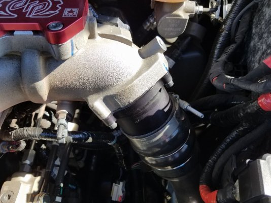

EGR delete plate (top left), throttle valve delete (lower right)

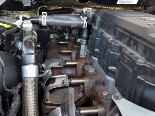

Here's a pic of the engine right side where the EGR cooler was
Stock EGR cooler

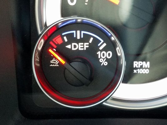

I've been trying to figure out what to put in this gauge spot...
