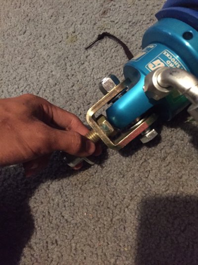

What do you think about making a 1/4" or 1/2" steel plate bolting it to the bottom of the lower arm via the bar pin mounts and using this adapter 39e09c1f0821a69ae2bedc82a8e68268.jpg

Too many failure points for my taste. It would work though.
What I'd do though is buy separate triangular shaped mounting tabs, (4 of them) and then weld them to the adapter that's bolted to the bar pin. This little stamped zinc coated u plates may not handle the stress and they can be a pain to weld on. 3/8" plate should be plenty for the bar pin adapter and the tabs are gonna be 3/8" or 1/4" and then just grind/cut them to fit.
Pm me some pics when it's done. I'm interested now. I've got my wife's old '10 I can't fogure out which direction I'm gonna go with it!

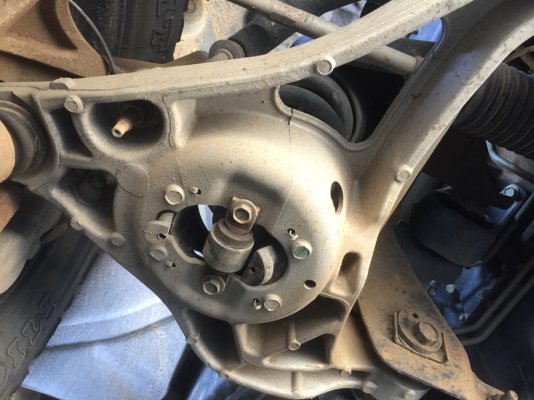

Do you have any pictures of the mounting tabs your talking about ? I'm familiar with fabrication but for my work not for my vehicle. I have welded aluminum before but am not great at it. That's why I was trying to avoid it haha. The adapter on the bar pin. There is no adapter just two bolts that hold the bar pin in place 66280b56d1eac2f2f88bc883462120fa.jpg
