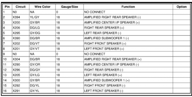

Think I found the wiring diagram ( not 100% ) if anyone knows for sure that would be awesome.

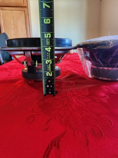

looks like a JL Audio 8inch W1v3 will fit perfect. This is a 4 ohm driver so you will need a simple amp. Like a Audio control ACM 1.300 or Kicker Key etc.
The JL is 1/8" taller and the magnet is wider but still fits in the box flush.
Measured the OEM alpine woofer at 3 3/4 inches tall and the JL just 1/8in taller ( 1/8 from the underside basket that lays flat on the box to the bottom of the magnet.)
The gasket on the JL is of better quality so that will add a very small amount of height almost making them equal.

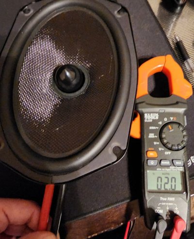

Just to add for informational purpose, looks like the Alpine OEM is 1.8 Ohm dual coil.
I got some Infinity Kappa693 6x9's and they state 2.5 Ohm and they are close at 2.8 Ohm.

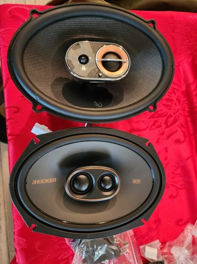

Were you able to fit those kappas in the front doors? I tried the gto 939s (same speaker for all intents and purposes) and they would not fit

Fyi the kappas won't fit, at least when I tried a couple years ago, In The front doors...I have them in my rear doors

Except the Kappas tweeters come with a fixed angle on them making them taller from magnet to tweeter. So the tweeter is touching the plastic on the door panel when installed. Shouldn't hurt anything but.....

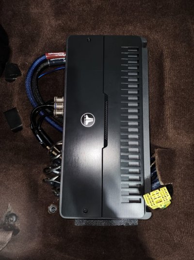

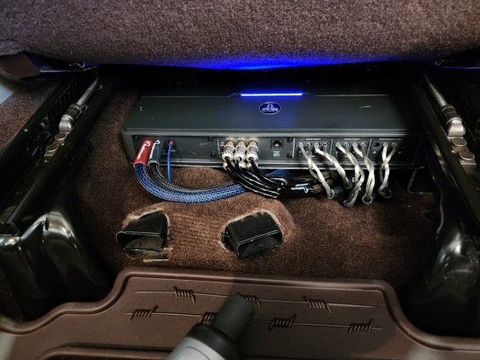

All done. Sounds really nice. Amp fits under the passenger seat no problem, removed jack probably will never use those small danger Jack's anyways.
I think I may remove the CDT 6x9 in the front. Sitting in the back sounds better than the front. I think it's because the Kappas in the back are full range and the front CDT are only 7khz. Kappa in rear sound really clean.
I did swap all 3 3.5 in dash but left them powered off stock amp. The doors 6x9s are powered off JL amp.
