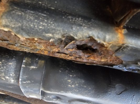

Had to take my Ram in to address some frame rot issues. NY salt!
Welder did say he rarely sees Rams. Most of the frame issues he has repaired are Ford and Chevys. He says the bodies rot, but typically the frames are solid.
This proves the Ziebart protection is pretty useless. Perhaps it trapped water causing the rust. Both issues are right between the gap by the cab and bed.

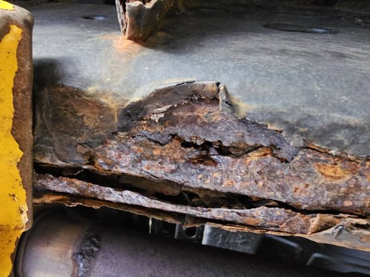

View attachment 572382View attachment 572380View attachment 572381View attachment 572379
Short version, on 3rd gen boxed frame they have no weep holes at the bottom of the frame. This might even cover the new generations. Add some drain holes at the bottom of the frame so the water,mud and salt can drain out. Easy test, stick your finger into a factory frame hole. If you feel a pile of rust, then you most likey will be losing the bottom 2 inches of the frame over time. Drill, drain holes, clean out the rust. You might at least slow the frame rot down.

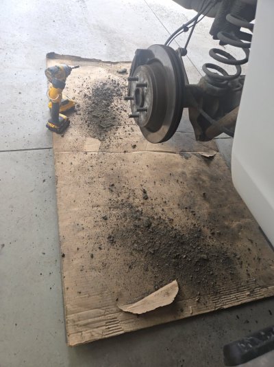

I love these oil spray threads. Up here in the north, bare minimum that is needed is annual thin oil base rust proofing. Id take it 2 steps further and try and wash once every 2 weeks as well as remove all the plastic liners under each wheel and clean off the inner fenders and box. Try and do it every 2 years and hit it with an oil-based rust protection like krown or fluidfilm.
I found the dirt caked along the wheel well prevents rust proofing products from penetrating as well as the dirt will trap moisture and salt. I learned the hard way. Had it professionally repaired.

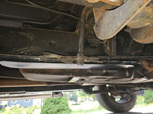

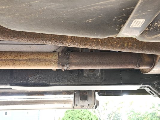

I live in the Northern Adirondacks which is a high salt environment. Purchased a 2013 RAM Tradesman new and it's seen this environment since then. No rust thru on the frame. Just surface rust. I have an outside faucet on my house and rinse off the salt on all our vehicles when the temperature rises above freezing. Wife's 2009 XTerra has seen this same environment. More surface rust on the underbody than the RAM but no rust thru on the frame. I personally would never use any undercoating on any vehicle. From my experience, it has been unnecessary. As they say in the military, it it works don't XXXX with it.

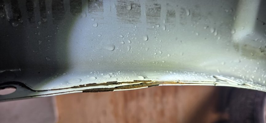

Forgot to add that I used Ziebart in the past on two older vehicles. Not to oversimplify things but the general principle back then was that it worked well until the coating became brittle and began to trap moisture, dirt and salt. Don't know the state of Ziebart today so can't comment on it.
That's what it's doing on the RAM. You crawl under there and you can see water dripping from a spot. The Ziebart is detached from the frame. If you pull away at it, you get more water out. I have a car wash plan. The car wash is about 1/4 mile away. Usually, I hit them up when on the way home. I also WFH. Sometimes the truck sits for weeks. It only has 89k on it for a 2013. It had 65k on it when I bought it over 5 years ago. lol.
I have a Charger that also has Ziebart. Since the frame is unibody it looks pretty good underneath for a 2010. The Ziebart is doing its job. I don't know what I'm going to do with the truck. Going to talk to them.
