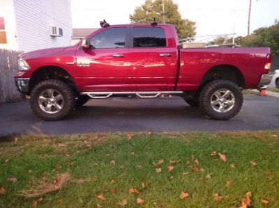

Hey ram world. Does anybody have 4.56 gears in there 2013 ram 1500. I'm in the middle of my swap and boy it was a ride. Almost done tho.

I did the 4.56 conversion

No I went through randys automotive in Washington. I bought the gears and the Lsd for the rear that was cut and dry. Now for the front you can do it yourself. But mine is lifted I don't think the 2008 front differential will fit a stock truck.

Took about a week but that is because I was identifing and locating parts as needed. But I would say if I had everything it would be about 2 days

Do you know about the ring gear in the front differential that's why we're limited to the stock 355,392,410s. mine is a 13 and I feel horrible ripping the front apart. I needed a 2008 front differential, axel cv, drive shaft but to get the gears that's what we need lol. Is your ram a 4x4? If not then you can get away with gears for the rear only a little more simple.
