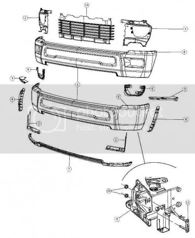

yes you will need 2500 hood,grill,bumper and bumper parts which are several
fog light bRACKET bumper brackets etc....
heres the things you nee for the bumper except for #12 on list that you dont need
hood and grill are plug in play but bumper is the only issue on this you need several guys to get that bumper aligned and other guy in the bottom to weld you have to cut a piece of your frame and weld the hd brackets into that is a pain but worth it
and if you shop around you might get it cheap as i got the hood from a local junk yard shop around ebay was a great help
if your interested shoot me a pm and can explain to you how you need to do it

That looks sweet I have been looking into going the HD route, how hard was mounting the HD bumper from what I understand this is the only troublesome area, everything else mounts right in.
yes to mount that bumper is a ***** big task but with patience you can get it done took me and my buddy 6 hrs an that was because that was only me and him with alittle more help you can get it done fast it is a pain cus you have to cut part of frame and weld hd brackets into your frameee before welding you have to align bumper
so 2 people holding bumper 1 person looking to make sure its aligned and the last person in the bottom ready to weld the brackets to hold bumper in place!!!!!
