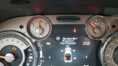

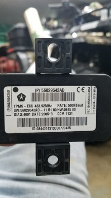

So a month or so ago, my service tpms system came on in the evic. The drivers rear was not reading any pressure. Being its a 2013 I figured its about time to replace them anyways so I bought a set of 4 OEM Schrader sensors. I had the tire shop install the sensors on my OEM wheels. The passenger side rear wheel then began failing to read pressure. Next thought.. must be a bad module. Bought a new module (same part number) and installed it. Drove the truck for a a week or so. Both rears would not register. I had appointment at dealer to do two recalls so I advised them about it while it was there. They were able to get the rears activated and the warning lights went out when I picked up the truck. On the way home, both rears again failed to sense pressure. Now, intermittently one or the other rear sensor will work, then suddenly quit working. The other day, all 4 were working, then the rears went out again.
Any suggestions on this one? Replacing the module and all 4 sensors did not seem to solve the issue of the rears not reading. Fronts read fine with no issues...

Last evening I swapped the wheels, back to front, front to back. I reset the sensors with my Autel TPMS tool and assigned them to the proper location. All wheels were reading at that point before I left. 2 miles into my trip.. ding ding.. TPMS warning light goes off and both rears were not reading. SO I have pretty much ruled out the sensors because the problem didnt follow the wheel location. Ive already replaced the TPMS module behind the front bumper and that didnt fix the issue. Pretty sure there is only one module. I guess it will be a trip to the dealer again..

There is just 1 module and 4 sensors so I'm thinking you have a loose,dirty or damaged connector somewhere given that the dealer has activated the replaced tpm module and it does work intermittently.
