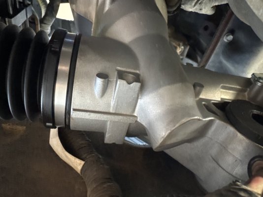

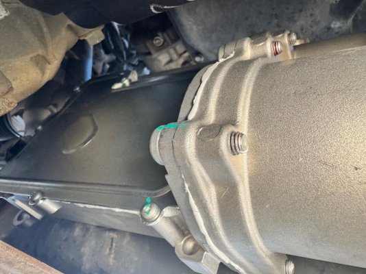

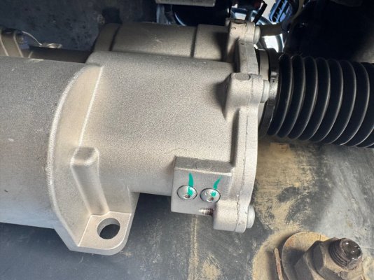

Yup, I have sent a certified letter of demand to the shop, taken my truck to a RAM dealer for check on whether the rack is OEM and to do a full diagnosis and written report. I will pursue a charge back on the CC , and send a letter to the California Bureau of Automotive Repair. Then I guess small claims court.
I am pretty sure that to rub salt into my wounds they used a Dorman rack , but charged me for OEM.

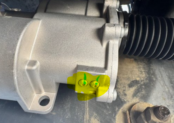

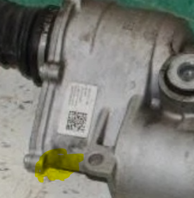

First picture is of a Dorman rack from NAPA web site - note the small round head bolts with green marks.
Second picture is from my car after these crooks did the work - I would say it's pretty damning , when I look at OEM racks I do not see these ( also confirmed by another poster)
View attachment 577018View attachment 577019

I took the truck to the RAM dealer to get an official report
They confirmed that the part installed by the indy shop was a Dorman 601-903
They can't calibrate it with OEM tools.
Truck drives like crap on 65-70 mph. It feels like I have an aggressive "Lane Keeping Assist" taking the wheel. I would not let my wife drive it.
Not using an OEM rack ( by CA law they are supposed to advise the customer and document non-OEM use) was just the cherry on top of their fraudulent behavior. I found the 601-903 on Napa for immediate delivery at $650 under what they charged me.
