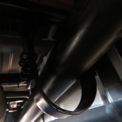

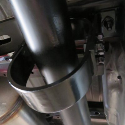

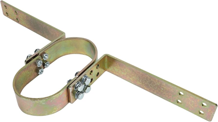

That loop can help to prevent the driveshaft from jamming itself into the ground and causing the truck to flip and roll over .
Do I have a story that can back that statement up!
Jan 17, 2016
23,902
55,071
14 Sport
Years ago we were farting around with my buddies 496 72 Chevelle,when he lost the front u-joint at about a 100 mph,after the shaft hit the pavement and dug a hole,it ripped the rear end and gas tank right out from under the car.
A driveshaft loop is always a good idea,and if you're on slicks,most tracks require a driveshaft loop.
NHRA wants a loop with-in 6" of the front u-joint,mines roughly about 8" back of the front u-joint,but i've never been tagged for it,being a couple inches farther back then required
