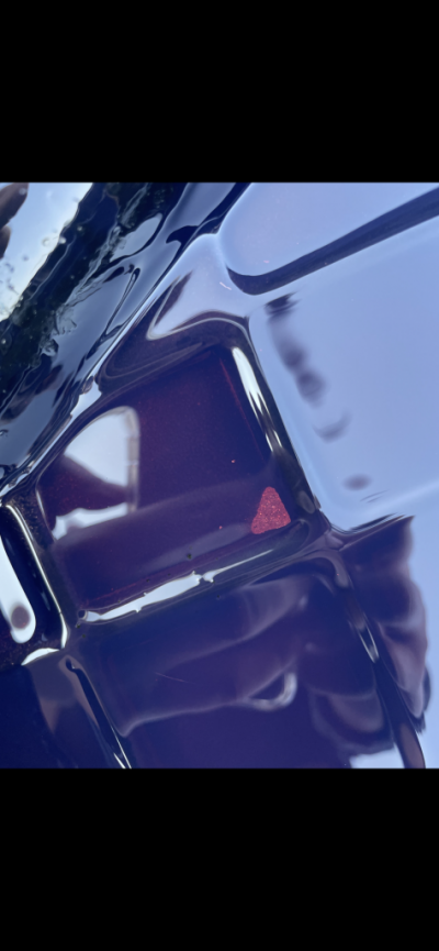

It’s probably jumping around 100-200 RPM. It happens when accelerating slowly in 4th, still no codes for it though so i’m not sure exactly what it could be. However when i dropped the pan i did find some interesting stuff i’m just not sure where it’s from. I’ll post a pic. I’m unsure if it’s from the converter but it would make sense if it was.

Ahh, I missed the 4.7. Def no MDS then.
Perhaps with the loose filter it was pulling air?
That’s what i am thinking. Probably needs a new converter even though i still have no codes for it.
