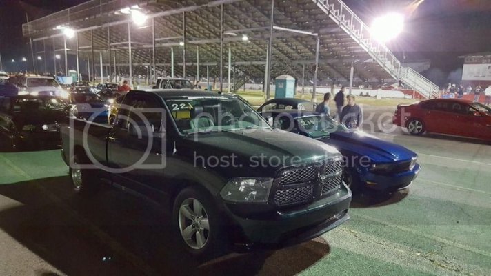

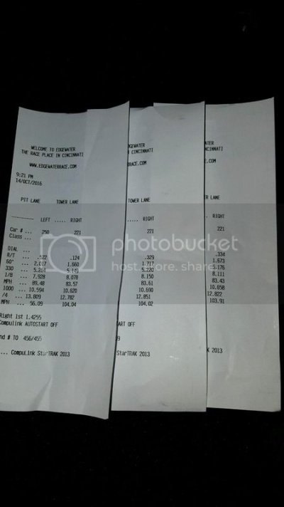

Had another customer break into the 12's N/A tonight with a 12.78 @ 104.04MPH. He has a custom track intake, Moe's 87MM Throttle Body, JBA Longtube Headers without cats, Moe's 4.56 Gears, Edge Racing 11" 3400 Stall Tq Converter, Clutch Fan Delete, and a Hemifever Custom Tune.
Check out that 1.66 60' time. This truck is a beast off the line.

He did a brake conversion and is running my old Mickey Thompson 275/60/15 drag radials on a set of Mickey Thompson 15x10 wheels.

A 0.069 second difference between three runs? Jeez. I could build a teepee in that amount of time. That's about as consistent as Hilary on her political standings. That's a bigger gap than the space between Michael Strahans front teeth. That's longer than leap year.
Ok, I'm out of BS. Nice runs. Was it warmer? I don't remember your initial time, but I thought it was quicker.
Edit: I just realized that wasn't your truck Matt. I was trying to talk some smack. I like the way it looks with just the slicks on the rear and stock tires up front. It looks less like bear on a bike at the circus. I bet it'd drop 0.01-0.02 seconds if you put pizza cutters up front though.

Very nice! Good r/t! Best I have ever hit was a 1.44 in a standard shift fix body in my teenage years. In my 20s the best I could hit was 1.6. I hate to see me in my 30s lol.
