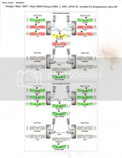

Went to the dealer today finally, as I figured I would at least get peace of mind just to have it on an alignment rack. It turned out the alignment has been off quite a bit, probably just poorly setup at the factory? I emailed Chrysler asking if they would help me out with the cost of the alignment since it is covered by their 12000 mile/ 1 yr warranty and I am at 9475 miles but just over a year and the tires have been wearing noticeably for a while since I noticed the wear at the first oil change. To add more insult to injury, MOPAR's website was showing a 20% off coupon for any service performed at this particular dealership before the end of the month, but when I presented it to the service manager before the service was performed, I was told that he had no idea what it was and had never signed up for this promotion, so would not accept it (he was nice about it and I left it there for him to give to his local MOPAR rep and ask "what the heck?"). So I asked MOPAR if they couldn't help me with the alignment, maybe they could help and honor the coupon for me since the dealer was not aware of the coupon and would not honor it.
We'll see if they will at least honor their 20% off service coupon if nothing else. I'm wishing I had realized alignment was covered under the 12k/1yr section of the warranty, as I would have had it checked at the first oil change before the truck was a year old.
