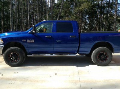

I just leveled my 2014 2500 with a2 inch spacer. Didn't affect the ride except the shocks are too short. Ordering new ones today. Other than that u cant tell the difference.

Zone Offroad 2" Leveling Kit - 2014 Ram 2500 & 2013-14 Ram 3500 4WD D1201
This is the level kit. Ordered shocks today but I didn't order them so I'm not sure on a part # on that. I think he was getting kyb's. My wife's uncle owns a tire/repair shop so he gets stuff for me. As of right now I have the zone shocks on that the kit recommends. There only an inch longer than stock so I'd like to get something longer. They ride better than stock though.

Very nice. What size tires did ya go to and are you going to get the shocks from the zone Web site. Thanks for the info btw.

295-70-18 34.4x11.6 I believe. Nitto terra grappler. The zone shocks are already on but I'm taking them back off as soon as the others show up. Want a little more travel. Stock shocks would clunk pretty loud on a rough bump like they were extending too far which they are. The zone ones haven't done it yet but they are only an inch longer than stock. Dealer where I bought my truck put a 2.5 inch level on a brand new truck on the lot. I stopped to check out the shocks they used and they were the stockers. I tried explaining they won't work but they acted like I didn't know what I was talking about which is fine. The new owner will find out...
