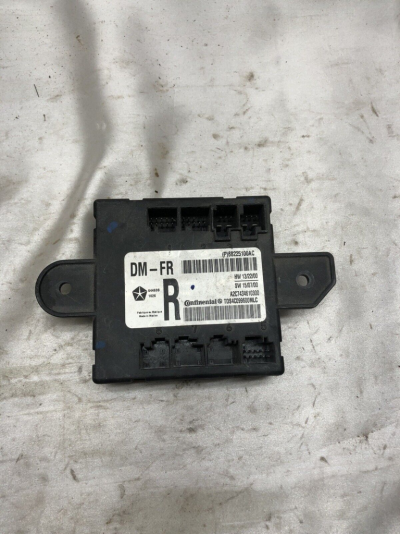

Done checked the connections. I’m guessing that the module is bad. No sure how you would check it to know for sure.

I had the truck scanned and the module is not communcating. Is there a way to know if its bad?

Did you check the driver's door wiring too? Inspect carefully in case wires are broken inside their plastic jacket. You might disconnect and reseat the module connectors if you haven't already. Sometimes, oddly enough, door modules can be a canary in the coal mine on battery health. They (on some vehicles) can be the first thing that goes flaky ...possibly because the ground is a lot longer(??), so if your battery has some age on it, get it load tested.
Another thing I'd do, is remove the door module, disconnect the battery cables and tie them together for a couple hours (not touching the battery posts). Let sit for 3 hours or more and then plug in the module, and then re-attach the battery cables.
Otherwise, you should be able to order a new module from the dealer, Amazon/RockAuto/Ebay ...and other places on the internet. The part number will be on the one you remove.
