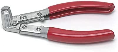

Omnisap, go to an auto parts store & buy a pair of pliers like below, then lift the battery clamp off of the battery.
Then insert the pliers inside of the hole & squeeze. That will open the clamp. it may cost you $15 cdn
One of the best tools ever for spreading battery terminal clamps

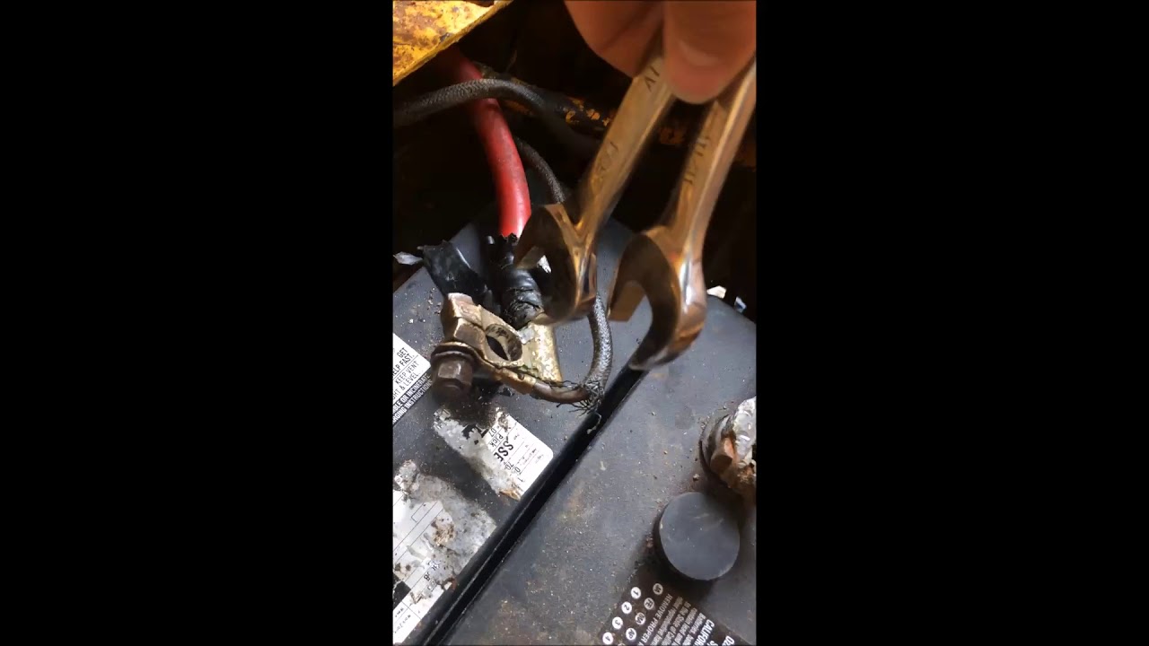

I never saw anyone spread the battery clamp like this before
I have neva used 2 wrenches, just hold clamp with vise gripe, put in a big bladed straight screwdriver and pry. It does not take a monster amount of force. Also clean terminal and lightly lube/grease, slide right on and bolt down. Just do not be a monster and break the "terminal" off the battery, ie., do not use a Torque Wrench.
