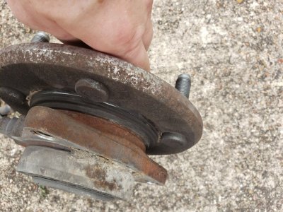

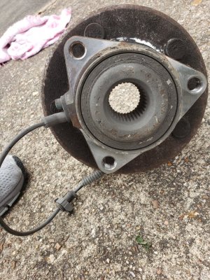

Mine did that and I replaced the hubs and problem solved.
