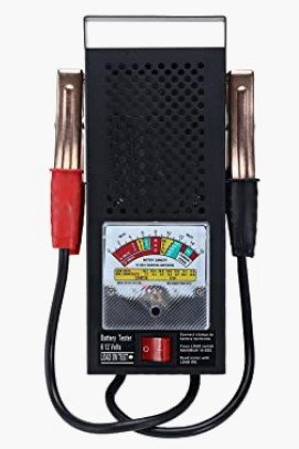

Those measurements look good. Yes, a load test with a toaster-style tester would be useful.
I'd still clean the battery posts & clamps and coat them with a thin layer of dielectric grease.
This action just removes another variable and when chasing electrical Gremlins, that often helps find a solution.
