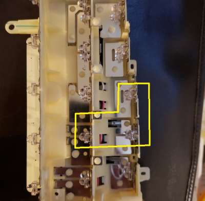

My sport has OEM LED tail lights. the right rear has 3 of the LEDs that will intermittently stop working causing the hyper flash of the dash and mirror blinker. Can the tail light be disassembled to check the connections of the LEDs?

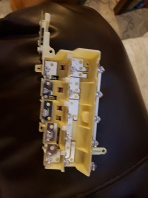

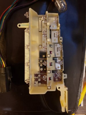

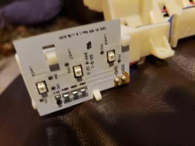

Its sealed, I have this apart from when the wife backed into a **** at the gas station. This is what it looks like dissembled.

This worked when I removed it. The red lens was all that broke. If you can figure a way to swap yours out I'll give you this one, just pay for the shipping. These oem tail lights are about 400.00. It's crazy.
