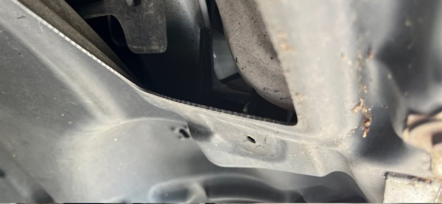

Apologies if already asked and solved, but I came up short after many searches. The wheel well access flap for the headlights in my truck uses a separate clamp, and when I pulled the headlights to change bulbs I put the clamps and fasteners in a plastic baggie and put them somewhere I could not possibly lose them, so of course I did.
My access flaps are not the one piece ones that just need a push fastener to hold them in place, Instead, it's a separate piece that hold the flap in place once it's attached to the wheel well with a fastener
Here the my fingers are holding the flap in place at the top and you can see the fastener hole at the bottom just below the end of the flap. I recall that the clamp (?) widens out where it covers the flap. I can probably fabricate something, though I no longer seem to have complete control of my hands, but does anybody know what this part is and where I can get it?

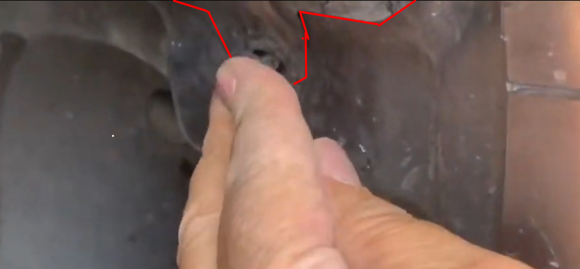

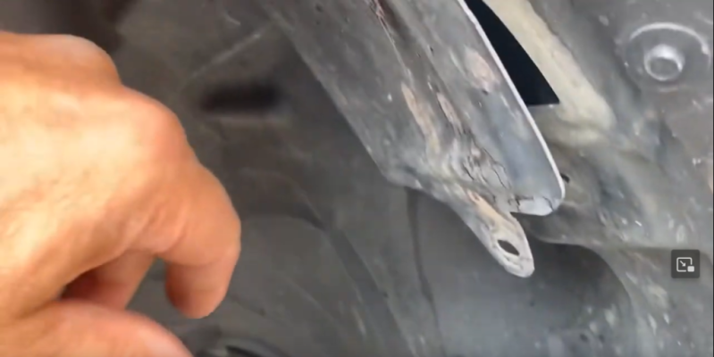

This might help. Confined to the house after some surgery, so using some pics from a YT video that I think will show the problem.1748798915772.png
My flap is like the one above (2014 model), but my flap (2015 model) does not have the tongue attached and is cut straight across. On mine there was a small bracket that replaced the flap that kept the flap closed. My guess was that they had problems with this style, then "fixed" it on mine, and finally went to the new style with a squared off flap that had the hole in the end of the flap.
Below is the 2014 style closed. It's a bit hard to see the flap outline so I added some red lines:
Basically the parts I misplaced replaced the tongue above. If I can't locate is I'm probably going to JB Weld some plastic to the flap and maybe reinforce it with some carbon fiber I have left over from another project. It's easier if I can find the part since my knees are shot so working in low places is less than fun.

This might help. Confined to the house after some surgery, so using some pics from a YT video that I think will show the problem.View attachment 567452

It's sounds like the flap on his truck doesn't have the tab where he could use a christmas tree fastener. Can someone with a 2015 confirm? My 2018 has the tab and fastener design.

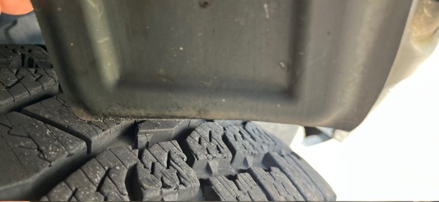

Some additional pictures (don't tell my surgeon I sneaked outside :) ). Thank all of you for your assistance so far!
Flap bottom is straight and there are no holes:
Opening without flap in place. The flap goes over the ridge just below the opening but no further, it falls well short of the hole.
You can see the end of the flap in this picture where I am holding it in place. the end of the flap is the dark line that goes to the side of my thumb then runs straight across above the hole. The missing part was placed over the flap and secured by a fastener in the hole.1748818118113.jpeg

Also, it looks that there isn't enough overlap to allow for drilling a hole or two in the bottom of the flap because of the way the flap is molded to fit into the wheel well.
