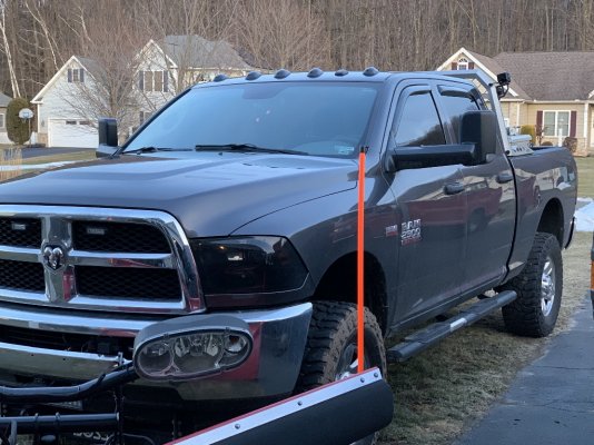

Thank you all for the warm welcome!! I’m very lucky to be within 2k miles of warranty and at a good dealer with good service (hope I haven’t spoke to soon). My Ram is in very good condition and now has a new motor, so I could be in worse shape! [emoji12] I did waste $700 on a battery and starter on the side of the road, but now it doesn’t seem like as much of a waste. I have a lot of time and money in that truck with exhaust, rear airbags, LEDs, hideaways, plow, etc and it was my baby for 4 years until the new truck, so it’s be maintained to the tees. Fluid filmed every fall, oil every 4K miles, you name it I did it and with the new motor it should (I hope) last for the next 10 years. Thank you all again for welcoming me and I’ll post up whatever ends up happening! Merry Christmas and happy holidays!

Welcome, Thats fantastic what the mother company did for you (FCA), I just purchased a fine Ram and I know what to look for and preventive maintenance, proper oil, mostly that I will do early on, hopefully I will be fortunate, with the limited warrantee that I have, how about some pics of your rig and don't plow with it any more time for a rest.

Thank you Mark! So far so good! The dealer (Drivers Village) in NY has been great! Broke down Sat night, had it towed and they called Mon morning 10:15 am and said I’m getting a new motor. The only thing I didn’t like was the charge to pull the plow frame. It’s a Boss push plate and 6 bolts hold it on. $450 seems a bit hi to remove it. I’ll talk with them about it when I go get the truck. I agreed to pay for new plugs and a belt. I also asked and will gladly pay for tranny flush.

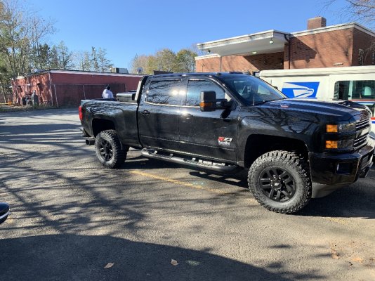

I’m not really brand loyal, I just love trucks! They all have their pros and cons. I have an older Ford F-350 7.3 too. The Chevy Duramax is the newest one. It’s badged as an LTZ beca it’s the z71, but it’s got all the options the High Counrty has. And I’ve quit plowing, not that the dodge did that much. We use equip to plow commercially, but I’m done with all that!

Hey OP, sorry to get off topic but how have u liked those STT Pros? Any info on their snow ability would be appreciated.

They work great. With weight in the truck I could plow in 2WD. They last about 35k or more if you rotate them and not that loud on the highway at all.
