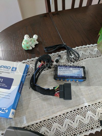

Well pac is installed, I feel like I owe someone money for pointing this little gem out to me.. it is amazing and solved my issues completely!!! Full signal to 20hz my system pounds now and eats these lows like a beast! Tuned to 25 may try to go a tad lower but what a difference!! Thank you guys SOOOO much!!

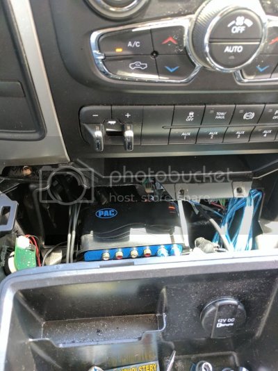

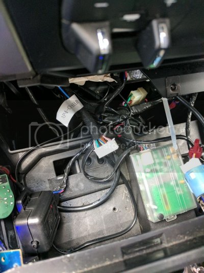

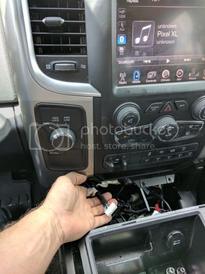

I ran the wire down to the area in front of the cup holders its a large open area and holds a lot of equipment. I have the viper brain, smartstart module, DBall module all of my sensors, tilt sensor, proximity sensor, shock sensor, glass break sensor and now the PAC amppro!!
All of my alarm controllers and sensors are in this area as well as you can see in the picture.
