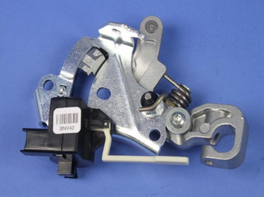

I haven't dealt with this issue, personally, but I would probably dig into the column, determine the cause of the 'looseness' you described. See if there is something broken or binding with the gearshift bracket (pictured below). Esp if it feels loose, maybe one of the cast aluminum parts cracked or broke. Maybe remove it and see if it moves freely. Check the switch too. Could be the switch broke internally and is giving 'errant' position readings and the computer 'thinks' its in a position it's not (and forcing it locked). It's not that expensive of a part (linked below). I just typed in specs for a 2015 2500 Tradesman ...so verify fitment in case your truck/part is different than pictured below.
If that doesn't do it, then it's probably time to drop the tranny pan and look up in there. Sorry I can't help more. Tackle the known issues first (looseness). Hopefully it gets you started.
