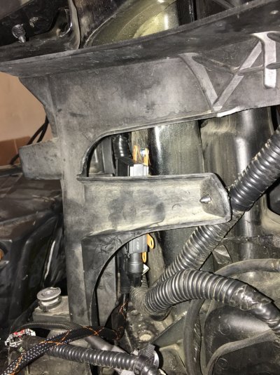

Install pics on a 2015 ecodiesel which had quads that I upgraded to a projector.

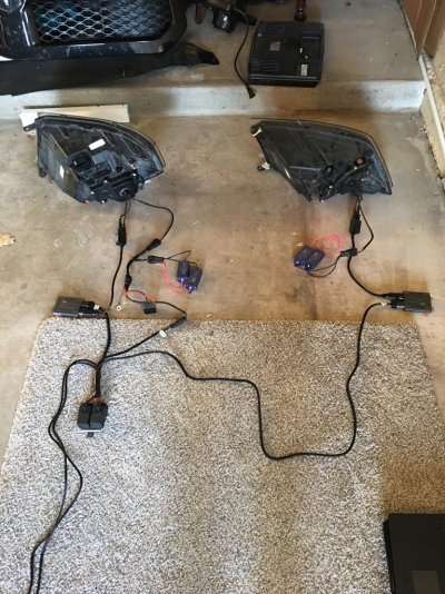

Here is the correct layout for the Retroshop HID KIT for a 2015

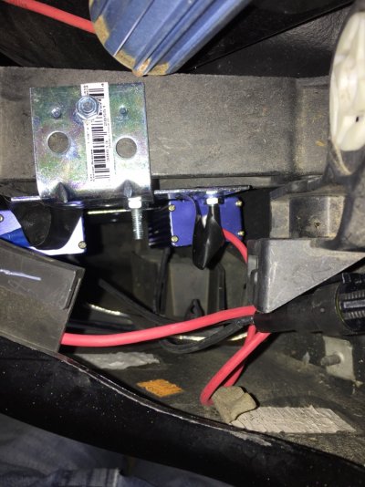

Here is a bracket I made for the HID resistors
Here is where I put the brackets on both sides

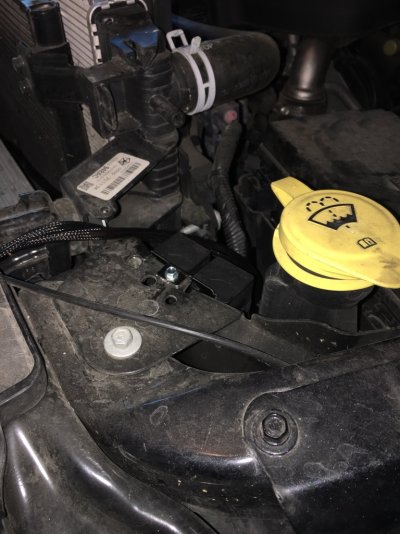

Here is the HID Ballast for the passenger side e0b78aa0e726e085b4a3a446ff248887.jpg
HID ballast for driver side

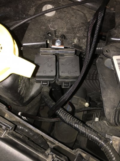

Here is where I put the wiring harness
Here is where I ran the passenger cable from the wire harness
