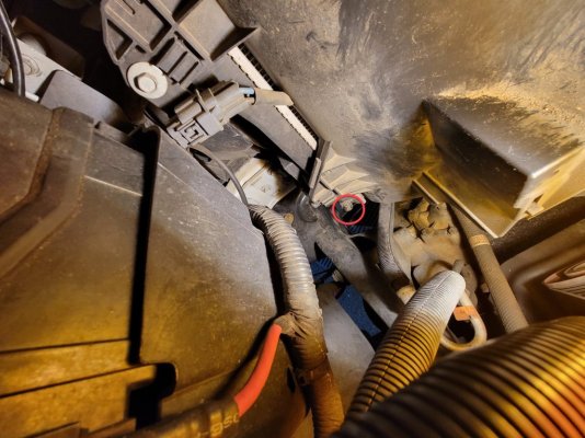

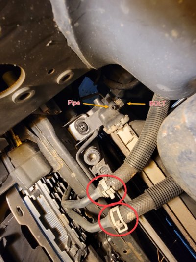

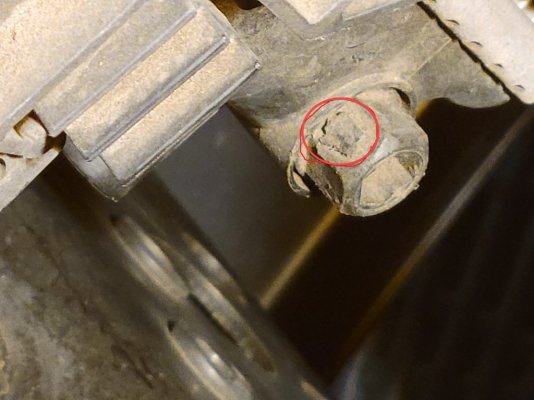

Hi again. I am trying to drain some of the coolant, but I am not sure if this is the right bolt (see pictures). It is on the driver's side. But there is a notch on it so the socket won't fit. (What the heck, don't understand??) Do I have to use a hex tool for it? Thanks

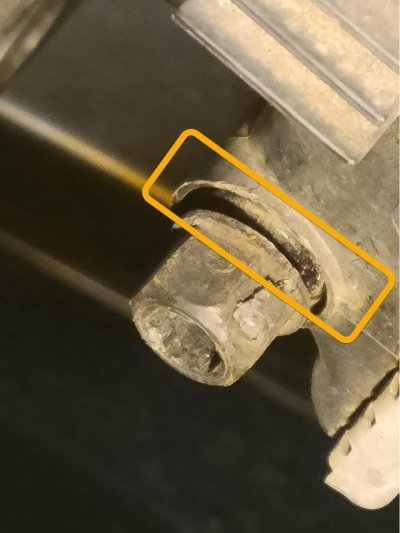

Anyway, I was able to loosen it, see picture..(I didn't want to go further, because it is not turning easy anymore, I don't want to break or damage)
But nothing comes out of the pipe, not a single drop. Am I doing something wrong?
Maybe I should just forget the pipe, and remove one of the fasteners to drain the coolant?

1) why are you trying to drain it? If you’re swapping the pump out, pull the upper and lower radiator hoses, heater hoses, and you will lose a little more as pull the pump itself off. No reason to use any drain bolts.
2) I’m not actually sure where that bolt is you are showing. Is that on the pump? Every water pump I’ve ever changed could’ve had that exact bolt, but like I said you don’t need to use it so that might just be why I don’t recognize it.

That looks like the drain plug. Since nothing started trickling out as you turned it, could be the radiator has a bunch of gunk in the bottom and is clogging it. You might want to consider a full system flush, recommend removing the radiator and flushing that separate to not push gun through the entire system. Read up on it to decide what works best for you. Could start with running water into top of radiator and let it run out bottom hose connection tube. Make sure you fill with correct MOPAR coolant mixture only. Replace thermostat while doing all this.

I am not at the water pump yet, still investigating. I overfilled the reservoir because of previous panic, so I wanted to drain some out. But as tron67j said, it must be plugged, nothing coming out.
The bolt is on the radiator.

That's the right "bolt" as you're calling it,it's the rads petcock.They can be a bit stubborn to turn out to where they let coolant come out the little pipe under it.Sometimes working it back and forth a couple times will help it turn out to where it'll drain,just don't wind it all the way out,as it can be a royal pain to reinstall.

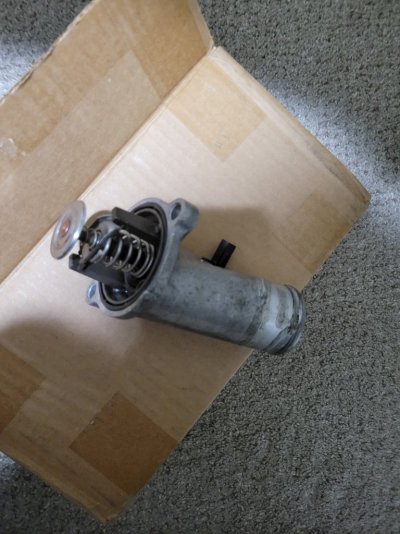

I removed the thermostat (it wasn't too bad by using a long arm socket, but the electrical connector was pain in the neck). 1) Is there any way to tell if the thermostat is broken before buying a new one? 2) Is it possible to short it by removing the thermostat from the housing and just use the housing for water flow? Thanks

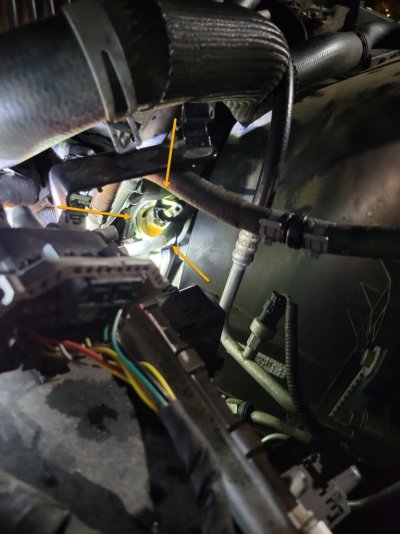

Here is the picture of the hole where the thermostat resides. When I run the engine, isn't the hot coolant supposed to spit out here? I ran the engine about 10 seconds and no coolant came out of it?

You may have a blockage, flushing will tell a lot. You can heat the thermostat up in water and see if it adjusts at the unit's operating temperature.
Hard to tell what is going on from typing, I recommend flushing and replacing thermostat to remove those as possible problems. Fill with correct type of coolant at recommended water/coolant volumes.
If you've drained a fair bit of coolant as it looks like from the photo,there won't be any coolant coming out of the thermostat hole.

The single OBD code in the reader was P2181, "cooling system performance"
That code can illuminate if the engine takes too long to warm up, most likely the thermostat is going bad.

No. Actually I filled up the radiator from the top radiator hose, and it started pouring down from the thermostat hole in the picture. Doesn't this show that the coolant in the radiator going thru the whole engine all the way to the thermostat hole?
I will install a new thermostat tomorrow and see what happens..
